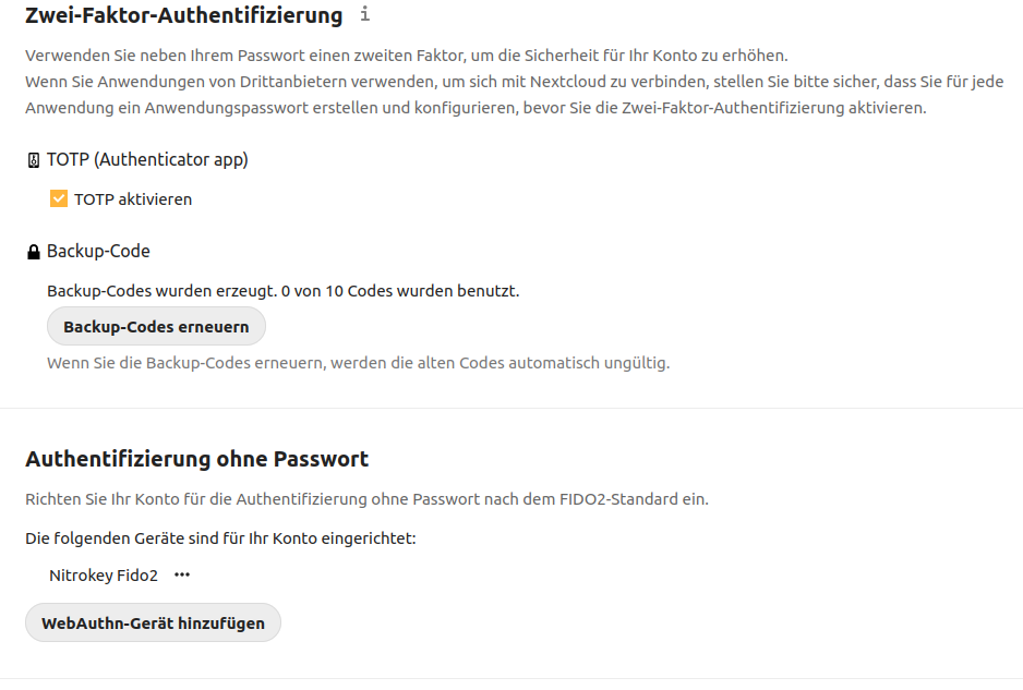

  • Not working is 2FA with Fido 2 on the Nextclouds itself. I miss the possibility to setup the stick. In both of my Nextclouds V.26 and V.27 I have the following dialog:

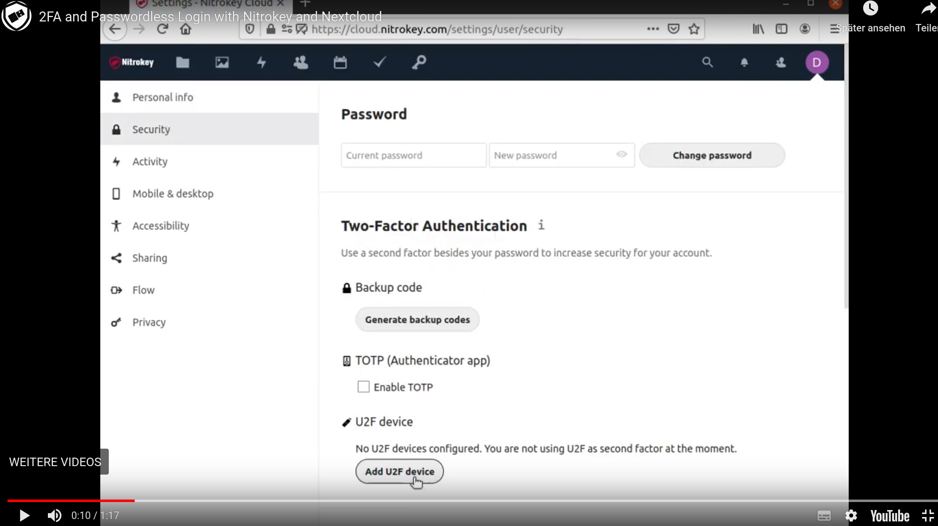

Whereas in an instruction video I saw a different dialog to set up a U2F device.
Photo follows later due to forum restriction for new users… :confused:

Second photo…
Meanwhile I found out by myself why the Nitrokey Fido2 does not work in 2FA.
The Nextcloud App “Two-Factor WebAuthn” must be installed.
Unfortunately the App is not available in the Appstore of IONOS managed Nextcloud - at least for the moment.
