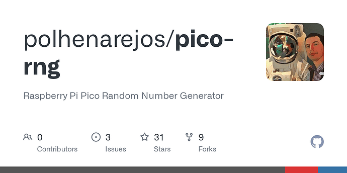

As for the tests themselves, it’s worth taking some time to explore the GitHub project pico-rng. There you’ll find documentation and references that allow you to gradually work your way to the relevant findings. My personal tests were conducted on an older HP ZBook - admittedly, not exactly modern hardware. On the other hand, given the developments of recent years, particularly those affecting sustainability and our environment, it should be clear that we will need to use our resources much more responsibly in the years ahead. Those resources naturally include computer hardware. Choosing not to use the latest hardware generations should not mean having to compromise even a basic level of security, even if achieving that level is admittedly only possible to a limited extent.
Here is the link to the relevant project:
There you’ll also find references to the entropy tests, which you can easily run yourself.
It should be noted, however, that I consider the overall approach taken by this project to be rather questionable. One tool was removed without prior notice or explanation and converted into a paid version after the project owner had undoubtedly benefited from contributions by the community to improve the software’s quality. In my opinion, that intention should have been communicated openly from the outset. That said, I’m still a Nitrokey fan, although I also believe there is considerable room for improvement.

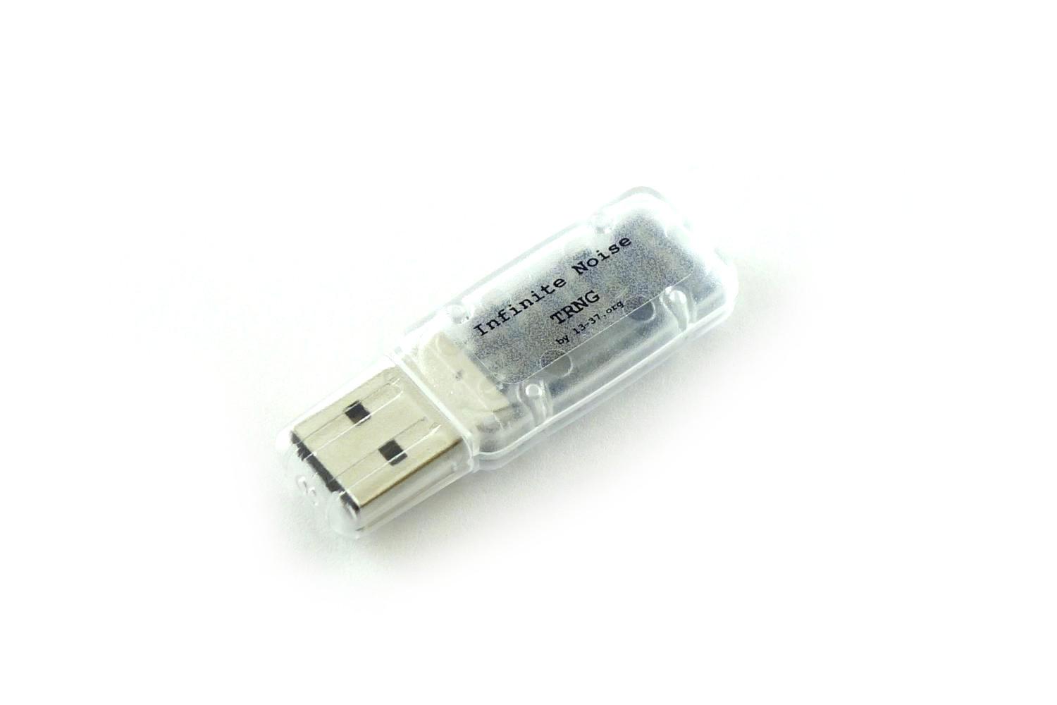

Maybe something like the following is what you need if you want something beyond the certified stuff
not very easy to integrate, but pretty well documented

Yes, thanks for the link; I’m familiar with that device.
But maybe it’s time to simply set aside all this USB overhead in security-critical areas and finally provide operating systems and applications that rely on good random data with exactly that kind of data directly in memory (via Thunderbolt, PCIe, and IOMMU), rather than struggling with USB shortcomings and USB protocols?
As I understand it, a solution like this could have existed years ago - and perhaps should have - since the necessary features have been available for about a decade, both at the kernel level and on the Thunderbolt side.
At first glance, such an approach seems to make much more sense from a purely technological standpoint than the USB solutions currently available on the market.
