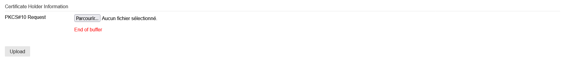

Expected results
Intermediate CA parameters are shown for approval
Actual results
An error message is displayed: “End of buffer”
Docker logs:
789404517 [qtp1526298704-19] INFO pki-as-a-service.ui.CAGUI - GET /paas
789405873 [qtp1526298704-12] INFO pki-as-a-service.ui.CAGUI - GET /paas/sr/new?process=PKCS10ServiceRequest
789435518 [qtp1526298704-16] INFO pki-as-a-service.ui.CAGUI - POST /paas/sr/new?process=PKCS10ServiceRequest
789435552 [qtp1526298704-19] INFO pki-as-a-service.ui.CAGUI - GET /paas/sr/9
789441235 [qtp1526298704-12] INFO pki-as-a-service.ui.CAGUI - POST /paas/sr/9
789441242 [qtp1526298704-12] INFO pki-as-a-service.ui.ServiceRequestController - postProcessAction action.pkcs10.upload
789441246 [qtp1526298704-12] ERROR pki-as-a-service.processes.PKCS10RequestModel - End of buffer
Is there something I can do to sign .csr emitted by ADCS?
