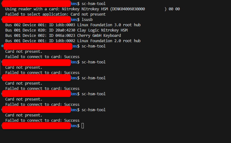

Hello,
could you please give me the output of this command under Linux:
sc-hsm-tool
do it several time
Hello Alexandre,
here is the output:
Sometime when I want to see the stored objects the pkc15-tool is in an endless loop. After 5 Minutes I usually abort.
Sorry for that, it seems that your NKHSM2 are having communication problem as explained here.
Please contact shop@nitrokey.com they will repair them.
