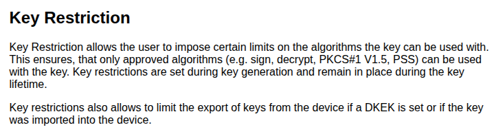

I just found that If I want to “export” the keys it works for all the keys except for the AES imported key.
I tried with sc-hsm-tool:
$ sc-hsm-tool --wrap-key /tmp/cmn_key_idx0-wrap.bin --key-reference 6 --pin 000000
Using reader with a card: Nitrokey Nitrokey HSM (DENK04021460000         ) 00 00
Connecting to card in reader Nitrokey Nitrokey HSM (DENK04021460000         ) 00 00...
Using card driver SmartCard-HSM.
sc_card_ctl(*, SC_CARDCTL_SC_HSM_WRAP_KEY, *) failed with Card does not support the requested operation
And also from Smart Card Shell:
>GPError: Card (CARD_INVALID_SW/27265) - "Unexpected SW1/SW2=6A81 (Checking error: Function not supported) received" in /pathto/scsh-3.18.59/scsh/sc-hsm/SmartCardHSM.js#1566
    at /pathto/scsh-3.18.59/scsh/sc-hsm/SmartCardHSM.js#1566
    at /pathto/scsh-3.18.59/scsh/sc-hsm/HSMKeyStore.js#287
    at /pathto/scsh-3.18.59/keymanager/keymanager.js#2882
    at /pathto/scsh-3.18.59/keymanager/keymanager.js#3229
But it works if the key is generated from Smart Card Shell.
$ sc-hsm-tool --wrap-key /tmp/cmn_key_idx0-wrap.bin --key-reference 9 --pin 000000
If I check the attributes of the “secrkey” (the one imported by SCS and the one generated by SCS), it seems to be the same attributes:
$ pkcs11-tool --module /usr/local/lib/libsc-hsm-pkcs11.so -l --pin 000000 --list-objects --type secrkey
Using slot 0 with a present token (0x1)
Secret Key Object; AES length 16

The error code SW1/SW2=6A81 (Checking error: Function not supported) can have a number of reasons:
  1. The WRAP attribute is not set for the key in the algorithm list (not to be confused with the PKCS#15 attributes that --list-object shows. There is no mapping between both).
  2. The KEK was cleared.
  3. The key has a key use counter (Exporting and import a key with a use counter defeats the purpose of having a single instance that counts key uses).
I guess in your case, the AES key imported with ks.importAESKey() does not have the WRAP (‘92’) attribute in the algorithm list, which is not set in DKEK.encodeAESKey().
Line 265 in DKEK.js says:
var aaid = new ByteString("10 11 18 99", HEX);
meaning that only ENC, DEC, CMAC and DERIVE are asserted. You could add ‘92’ to the list to see the effect.
