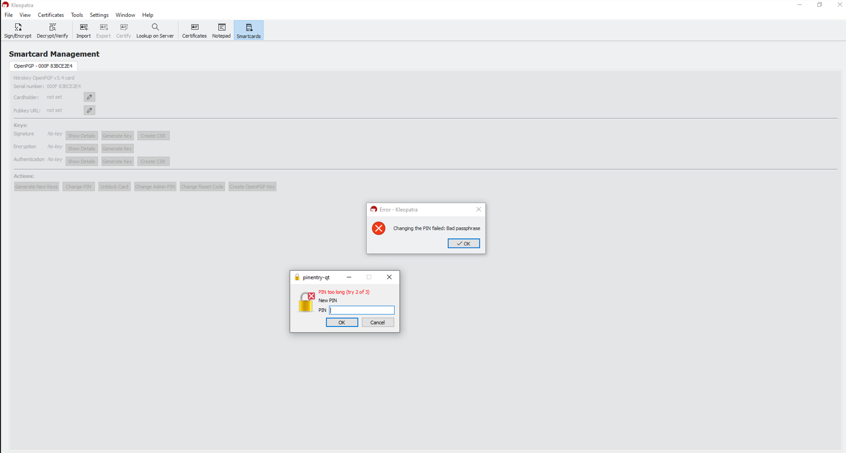

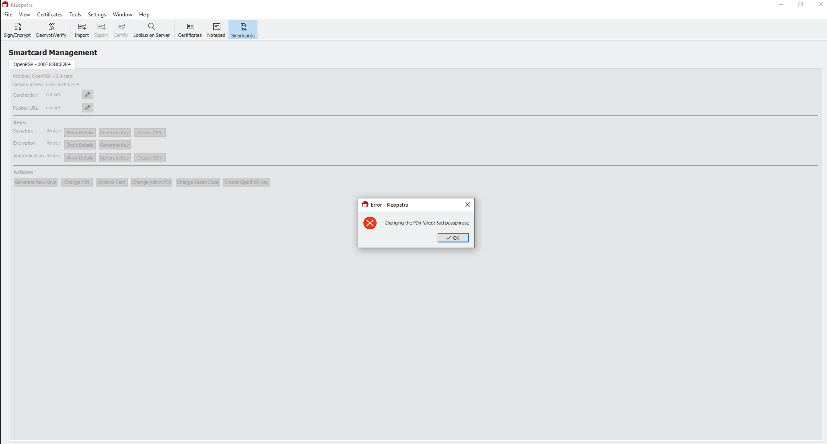

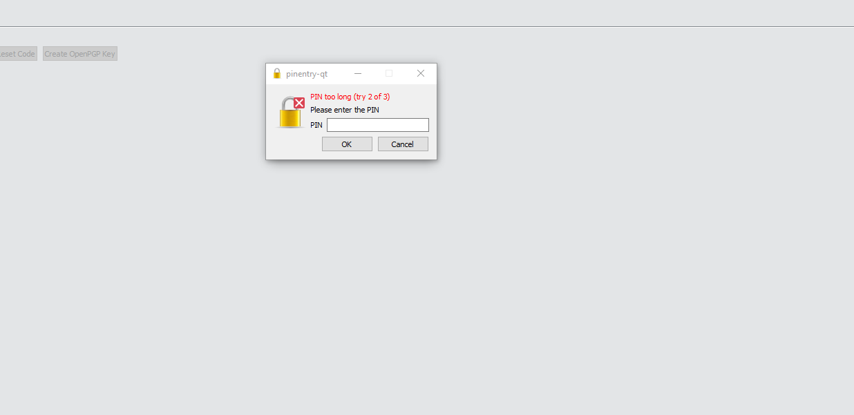

but it is showing an error when try to set length more than 88 charcters.
Take a look:
Change User and Admin PIN
Same documentation, it seems to be a question of implementation.

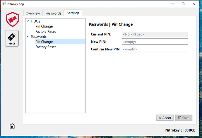

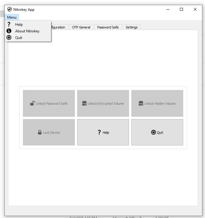

Would you please like to guide me which nitrokey APP works fine for Nitrokey 3A device . as i have installed nitrokey app that is showing nothing for my particular device.
Take this:
Nitrokey App 2
It is all in the docu you cited.
You get the most out of your key using nitropy.

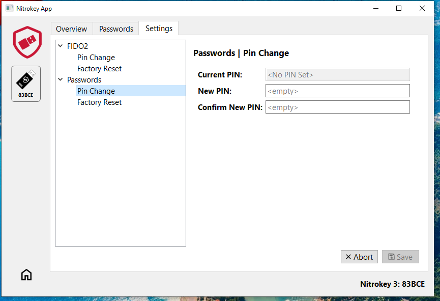

i installed this app as well on windows 10 pro.its showing just these options,no menu to change userpin
As you read in the docu this app is for fido2 part of nk3.
Nitrokey App 2 The Nitrokey App 2 is a graphical application designed to manage Nitrokey 3 devices. It provides a user-friendly interface for configuring FIDO2 authentication, passwords, firmware updates, and PIN management
You may install gpg4win, then you get “Kleopatra” as GUI to get your pins set.
I have already tested Kleopatra on Windows 10 Pro. The error image I shared earlier was captured from that application. It displays the same error as GPG on Ubuntu.
Then time is come to read about the right driver setup.

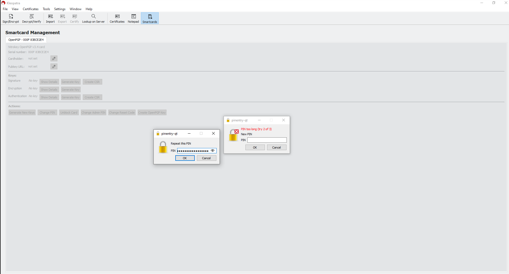

I am unable to set the user PIN to its maximum supported length of 127 characters, as mentioned in the Nitrokey documentation. PINs up to around 88 characters work fine, but anything beyond that length is rejected.
Could this issue be related to a missing or incorrect driver installation? Would installing the proper driver allow setting a PIN of the full 127-character length as stated in the documentation?
Hello, 127 is also not possible on my side. I think the maximum depends on some configuration.
