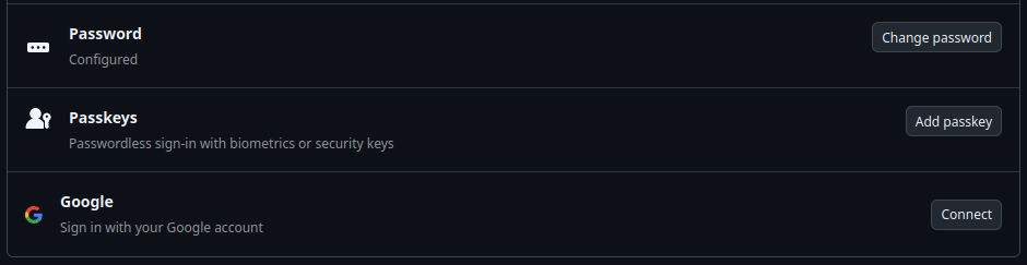

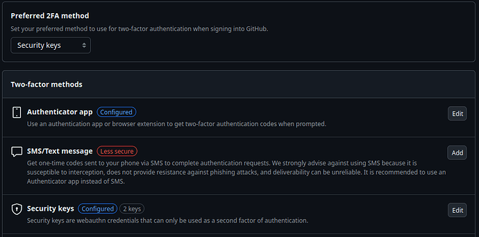

I actually originally set it up that way because I accidentally missed the distinction on GitHub. However, after realizing that I definitely didn’t want to leave the current state as it was due to the associated security concerns, I deleted the keys as passkeys and set them up as security keys.
Therefore, that can’t be the problem.

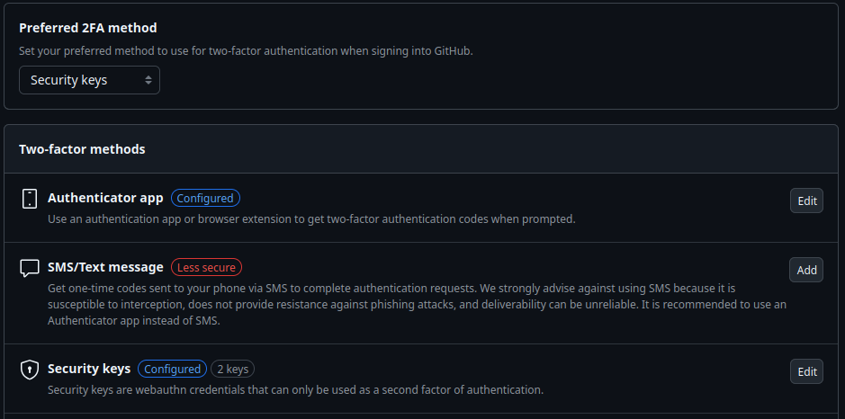

Attached is a screenshot that confirms this.
