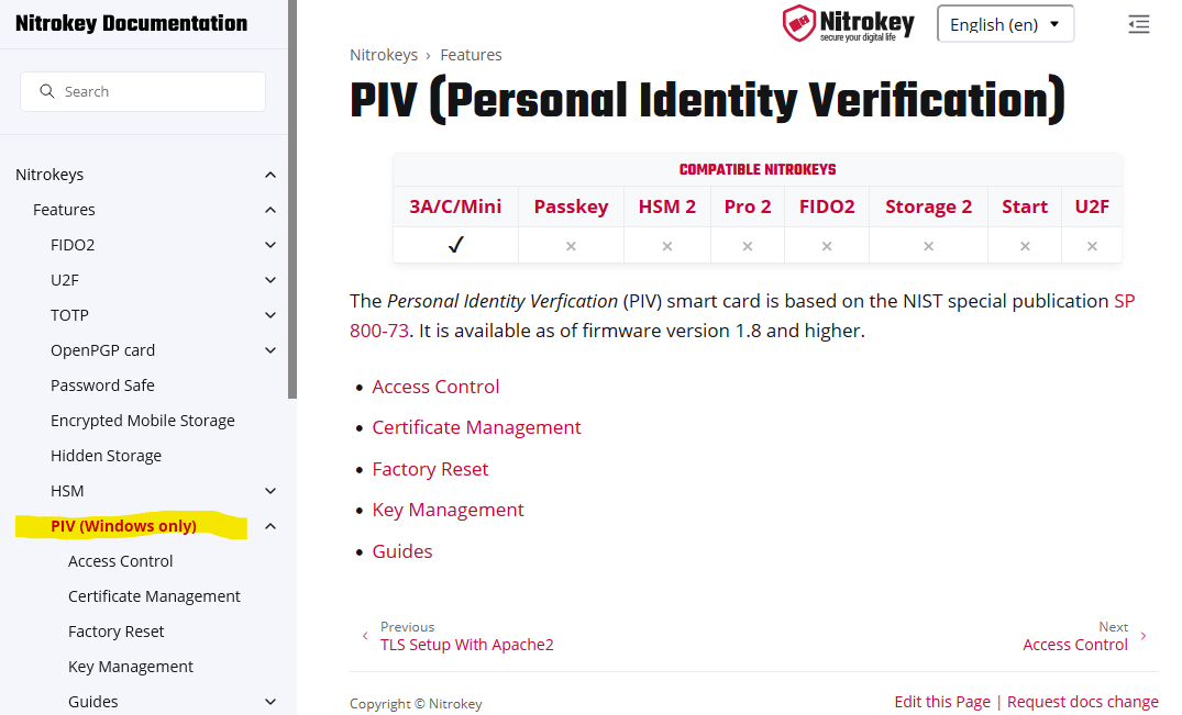

Attached question would be how mature is the piv --experimental support cross platform, and if it’s a wrong direction to explore programmatically right now. Is it ONLY for windows - and that’s why some commands are failing?
Take a look:
