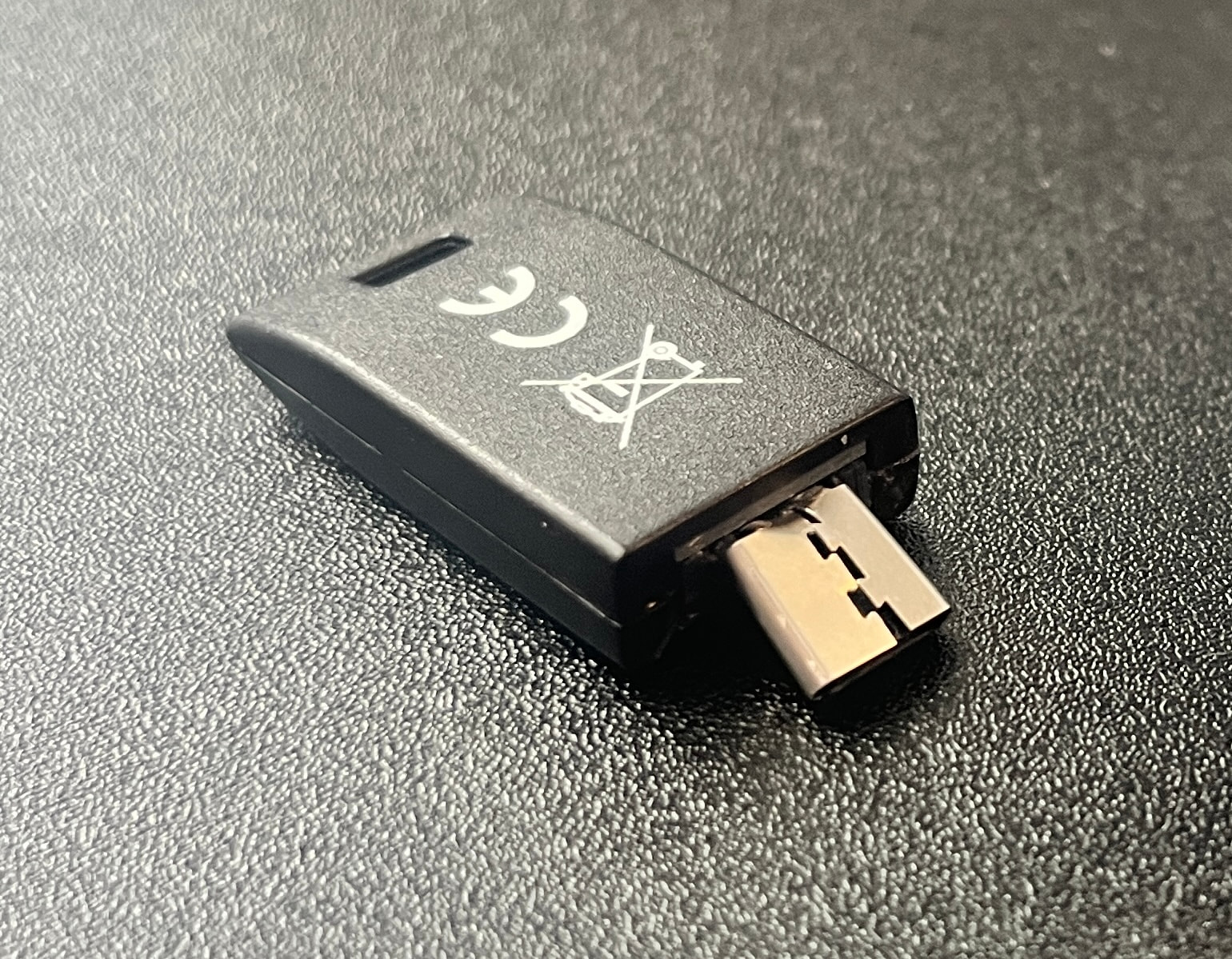

Nitrokey 3C NFC bent
My laptop fell from table height on to my primary Nitrokey 3C NFC in the USB-C port. It got pretty badly bent and will no longer fit back into the port because the shape is wrong.
I still have my secondary. But I don’t understand the concept of buying a new one and making that my new primary. (Or using my secondary as my primary and making the new one my secondary once it arrives.) Is there documentation on this procedure? I’ve gotten very confused.
You may still be able to salvage it carefully, but that does look bad indeed.

Thank you! You have shown me how I was thinking in a way that introduced complications that simply do not exist. Your reminder that there is no need to sync PINs got me thinking more clearly about how I am using this hardware.
