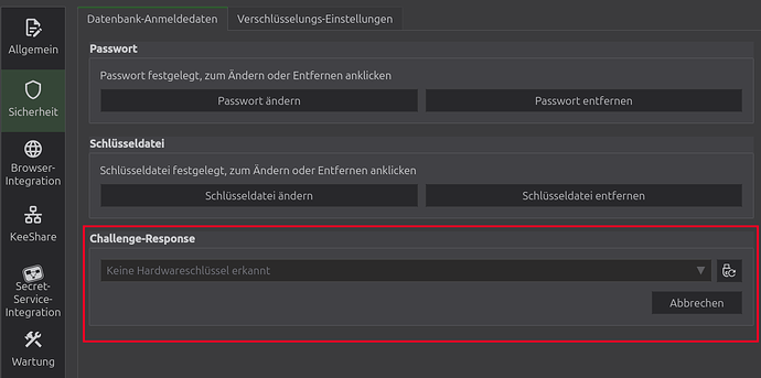

I’ve had a look at the keepassXC github page. Couldn’t find any reported issues there. So it seems that other hardware keys under Linux are not affected.
Under Windows 10 no issues. The key is detected. Same keepassXC version 2.7.10 on both OS.
Screenshot Linux attached.

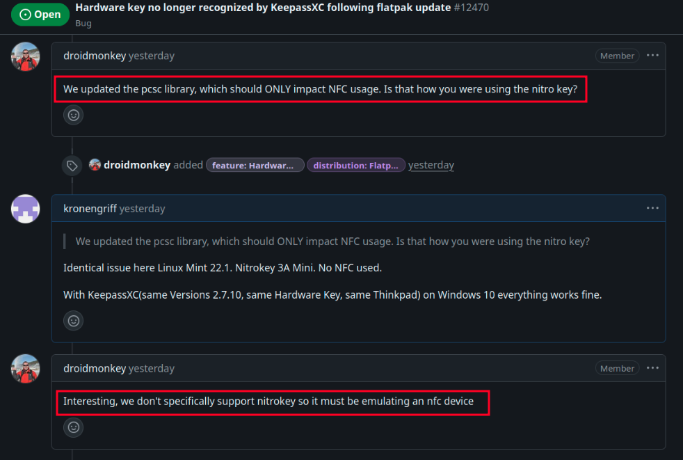

I’ve opened a github issue; let’s see if we get some further ideas over there.
" I’ve opened a github issue" - Perfect! Thank you! There is a response already:
“We updated the pcsc library, which should ONLY impact NFC usage. Is that how you were using the nitro key?”
So I’m definitely not using NFC.

For others who might follow this, here ist the latest response from KeepassXC. They speculate that the Nitrokeys are emulated as an NFC-Device, as there ist no special hardware support from them. See attached screenshot.
