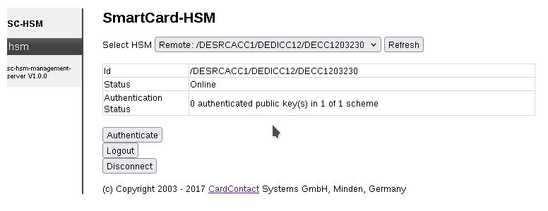

What I have in mind is a little different:
We have PKA in the portal, which implements the required authentication steps with a device that is remotely connected. We could integrate this connectivity behind the C_Login call in the PKCS#11 module, so that whenever an application calls C_Login, the token is connected to the portal, where you could perform PKA. If PKA is complete, the connection is closed and C_Login completes, allowing the application to continue.
That would allow arbitrary applications to use PKCS#11 without adding user-facing support for PKA.
There is the sc-hsm-management-server repo in the CDN that implements just the PKA part in a simple web service, if running the full portal instance is too much.
