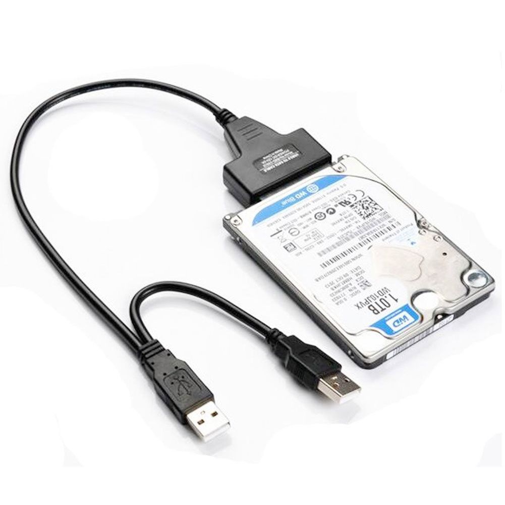

Big drives can draw a short power spike when they spin up. You can get USB cables that take power from two ports, which can help make things more stable. A powered USB hub should work too.
