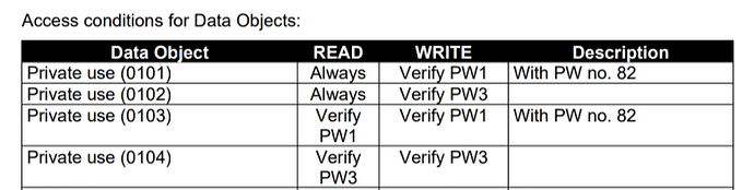

After a bit of research: Private Data Object 01 is indeed supposed to be always readable, according to the OpenPGP card spec 3.4.
So, how do I get VeraCrypt / the Nitrokey to use PrivDO3 instead?
Imho, at the very least the documentation on the Nitrokey site should be removed or reworked, since having a key file always accessible defeats the purpose of putting it on the NK3 in the first place.

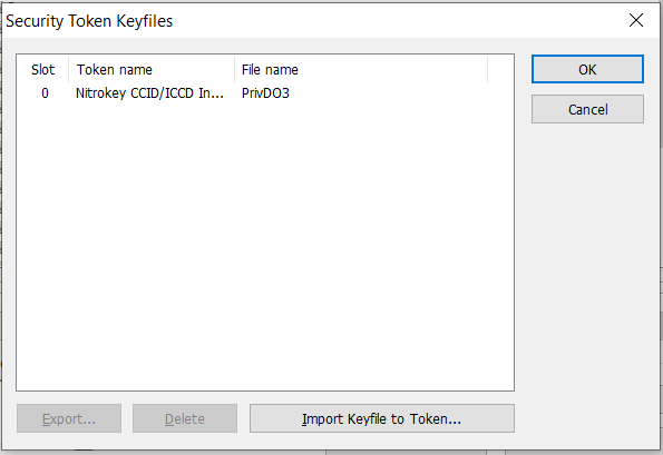

So, I’ve been writing my own PKCS#11 library from scratch that exposes the PIN-protected PrivDO3 to VeraCrypt to use as key file. It’s working now:
… though perhaps lacking some error handling and documentation. Depending on my spare time and public interest, I might polish it for future release.

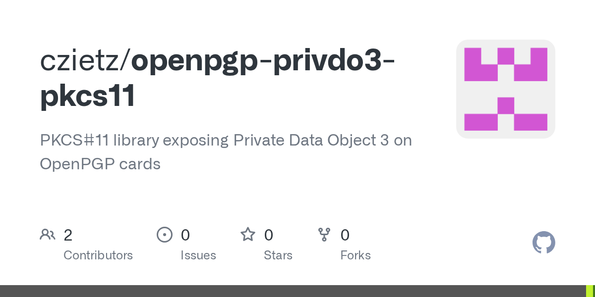

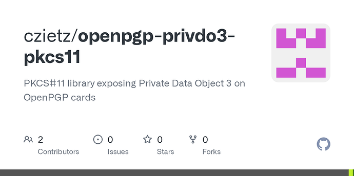

Here is my PKCS11 library that allows VeraCrypt to use the PIN-protected PrivDO3 on the Nitrokey:
I’ve been using it daily for about a week, without encountering issues. But please note that it is provided “as is”, according to its license terms.
