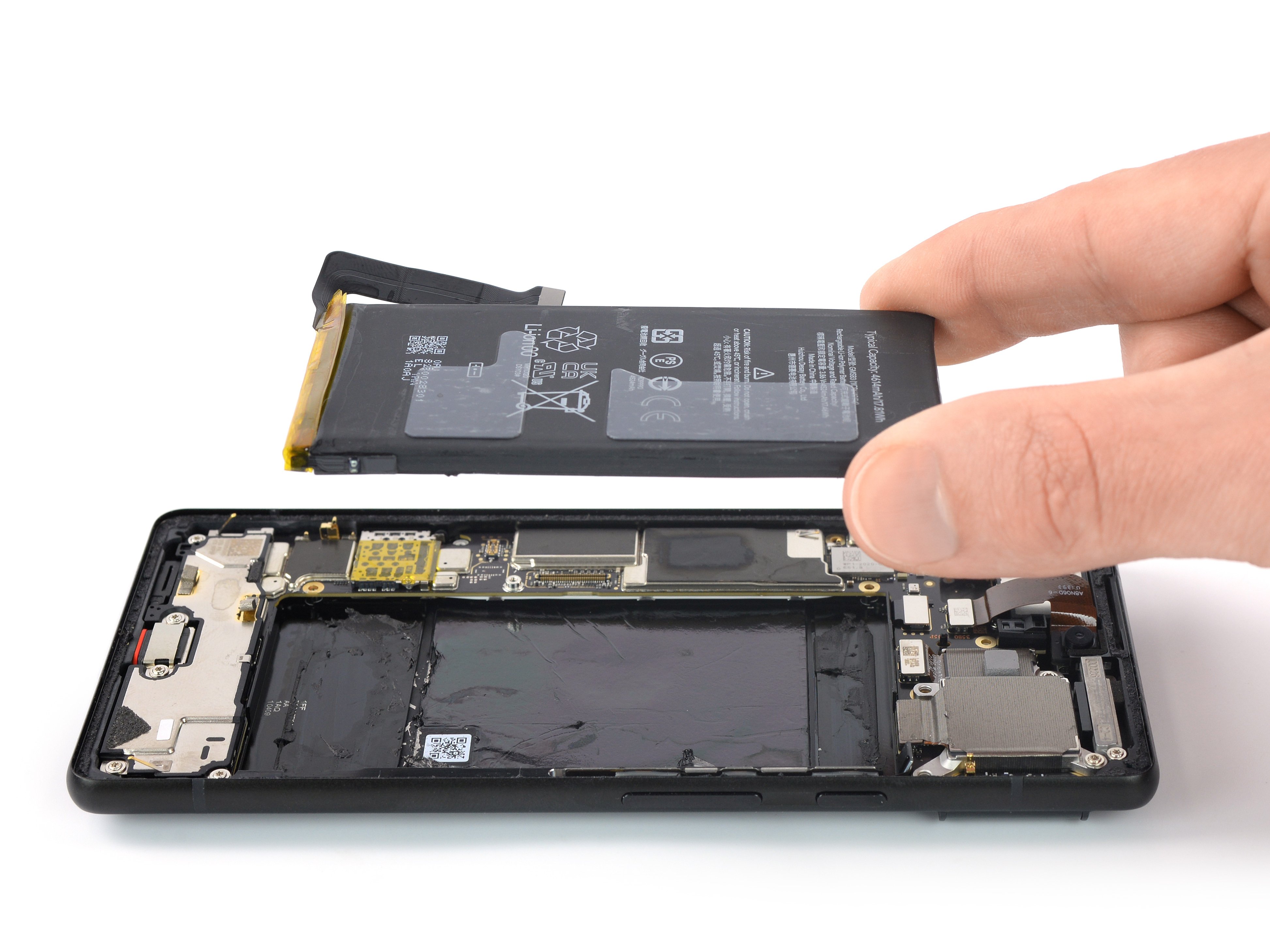

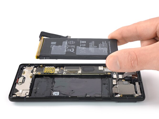

Any phone repair shop should be able to do it.
If you feel confident and if you have the needed tools you could also do it on your own:
