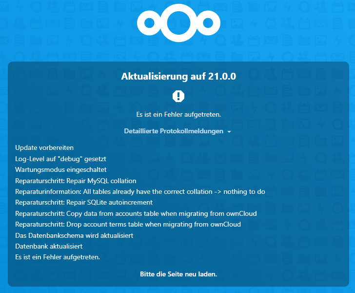

happened to me. The web interface showed the dialog with the update option as the only choice, however the update failed for some reason and the nextbox remained in maintainance mode. Manually switching off the maintainence mode takes me back to the update window. I am kinda stuck in a loop here.
Any ideas what i could do? Thanks!

Yes, I did try several times to switch off the maintainance mode which worked by shortly pushing the hardware button once, however, as you anticipated I got back to the update screen with the one update button only all the time. I repeated that several times and also restarted the nextbox by un-/re-plugging the power supply without any change.
mmh, this is bad, the update mechanism from Nextcloud is not equipped with a fallback for these situations. Especially bad is the fact that this update has actually not introduced any Nextcloud specific update (the next one will do so), so I am really puzzled why this is happening for you guys. The only explanation I could think of is a Nextcloud app you might have installed that does something weird during the update.
If disabling Maintenance mode and restarting the process does not help, I am afraid you can only factory reset your NextBox. I would be very interested to get the logs after you did this, please send them to support@nitrokey.com so we have a chance to analyze them in order to maybe introduce mechanisms to avoid such cases in the future.
