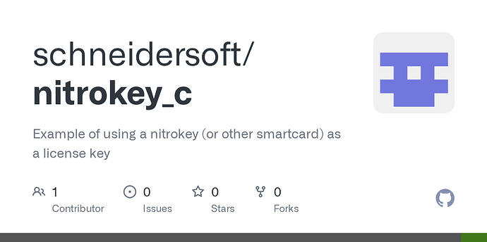

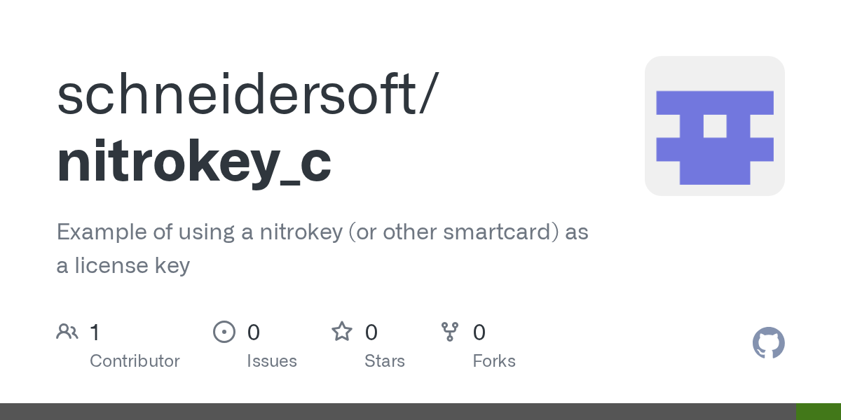

Looks something like this in C:
ended up using ed25519 because there’s a convenient MIT licensed lib for it and getting gpg to do secp256k1 or some of the other common curves requires extra steps.
zero deps beyond pcsclite/winscard! yay!
